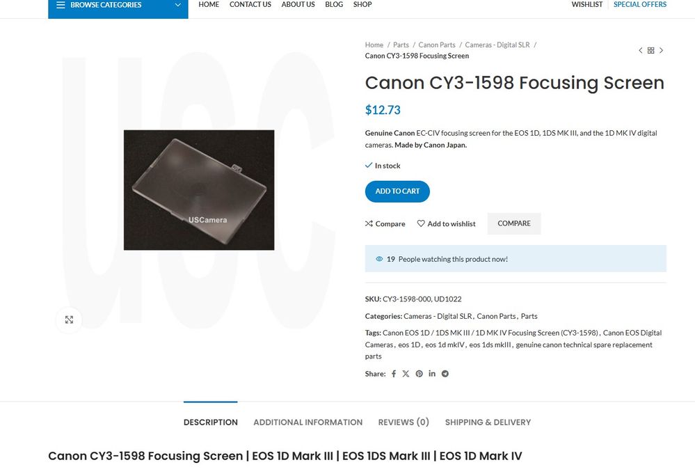

From USCamera-dot-com
John Hoffman
Conway, NH
R6 Mark III, M200, Many lenses, Pixma PRO-100, Pixma TR8620a, Lr Classic
Waddizzle
Excerpt from artile linked just below….
Ec-C IV Bright Laser-Matte. This is the standard screen for the EOS-1D Mark III/IV, and 1Ds Mark III. It has the same markings as the Ec-C III but is brighter, less grainy and better balanced.”
https://support.usa.canon.com/kb/index?page=content&id=ART170209

It isn't impossible for a focusing screen to be damaged while mounted in the camera but more likely a bit of debris or some other foreign material is in the center area.
1 series focusing screens are easy to change so I would first pull it and check it and if it is actually damaged then replace it.  There are several optional screens for 1 series bodies but unless you have special requirements, stay with the stock screen since some of the specialized screens will impact exposure metering and/or viewfinder brightness.
