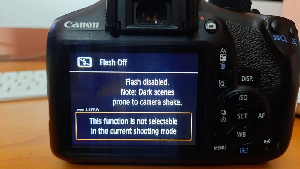

I am Using cannon Eos 1300d (Rebel t6). Now it showing “This function is not selectable in the current shooting mode” in all mode. If I try to factory rest “Clear all setting” not showing. How to reset my camera? Using computer?

You have not told us what shooting mode yo are using. ???
Some functions are features are disabled or enabled in different shooting modes. In order to reset the camera, that menu option only appears in the Creative Shooting Modes: P, Tv, Av, or M.

This is not off-topic. You're shooting in "Flash Off" mode in your photo above, which is a fully automatic mode other than flash is disabled. Please reference your manual to learn the different modes and how to reset your camera. You can find it HERE.
