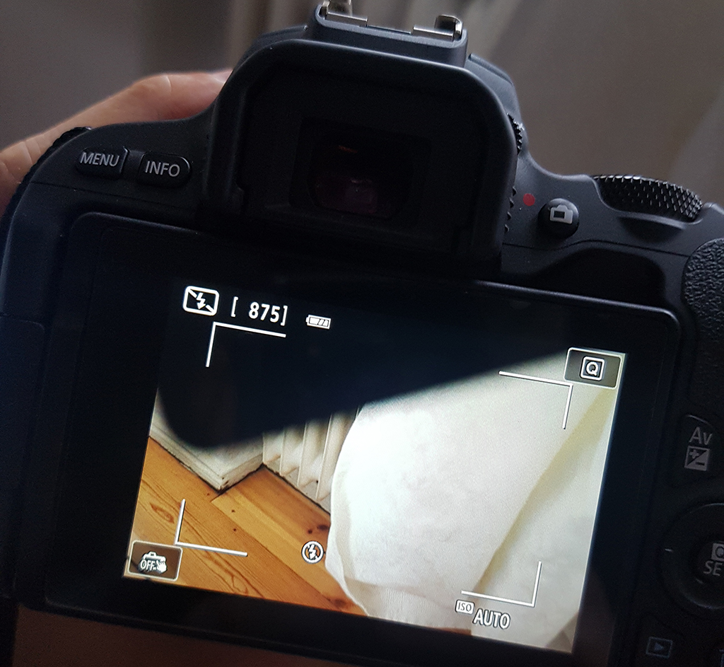

I have a canon 200D for 1 year +/- and the other day i was shooting in live view and it appear a black thing while i was shooting, i clean the leans + the sensor on the software and i change the lens also and the problem is still there.
Bellow you can see what is showing on my screem.
Anyone had the same problem or knows what is the problem?

Looks like a shutter blade that didn't get out of the way, i.e. a broken shutter. Usually not an extremely expensive repair, but not a do-it-yourself project either.

Greetings,
Do you see this in your photos?
That looks like the shutter is binding.
Edit ***Yep.  Bob confirned it.

Yes i can see this in my photos 😞
I dont understend how it happens, i always took care of the camera, and sometimes this black thing moves...
I will have to send to repair as is still in the warranty
