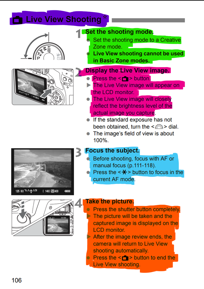

@JacksonBeaven what do you mean by you took out the sensor? How did you clean the camera? The AF sensor for viewfinder shooting is under the mirror. What lens are you using please provide the full name of the lens. How are you trying to use AF in Live View. If you're trying to use the shutter button to activate AF that's NOT correct button. The "*" is the correct button to activate AF in Live View shooting mode. So it appears the camera is functioning correctly. I have pictures below to help you identify the lens you're using and how to find the Full and complete name.

I had no idea about the * key focusing in live view. Thank you for clarifying that.
It seems to have fixed itself after a firmware update. No idea what happened. Thanks again for the reply, appreciate it.
