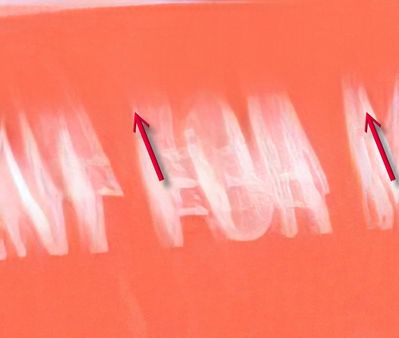

@CVOHDrider58 wrote:
This image is blurry because of lens shake. I'm not saying other images you've taken may not be soft, but this particular example.
Here is a crop around the word "FOR" taken from the above image and enhanced to show the lens movement.
First, I would get my SS up above 1/500 (this shot is at 1/160th), also figure out a way to get your ISO down. The images you posted were both at 10,000. Was the light that bad? I've shot with this lens, but sold it and bought the RF 200-800mm which is more expensive, but is a stop faster at 800mm (f/9) and has much better optics. 800mm is a little tough to get used to. Lens shake is exaggerated and although IBIS and ILIS really help, you have to be pretty stable to begin with. I use a monopod and any nearby tree, if there is one handy 🙂
