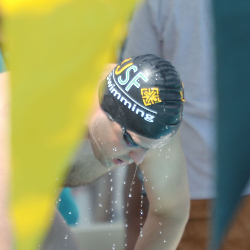

The fuzz is evident on the long line on the swimmer's cap and other action photos I've take.

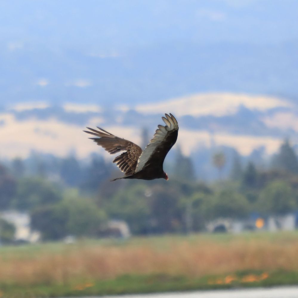

The reason I'm posting this is because a year or two back the converter worked much better!
Look at this much better photo at 400mm, full-on AF.

The bird looks okay to me. It seems to me that there is more unsharp mask than is my preference.
I see from the exif data that Picassa software was used. Did the behavior change after switching to that software or upgrading that software? Have you tried processing the raw file with Canon DPP software?

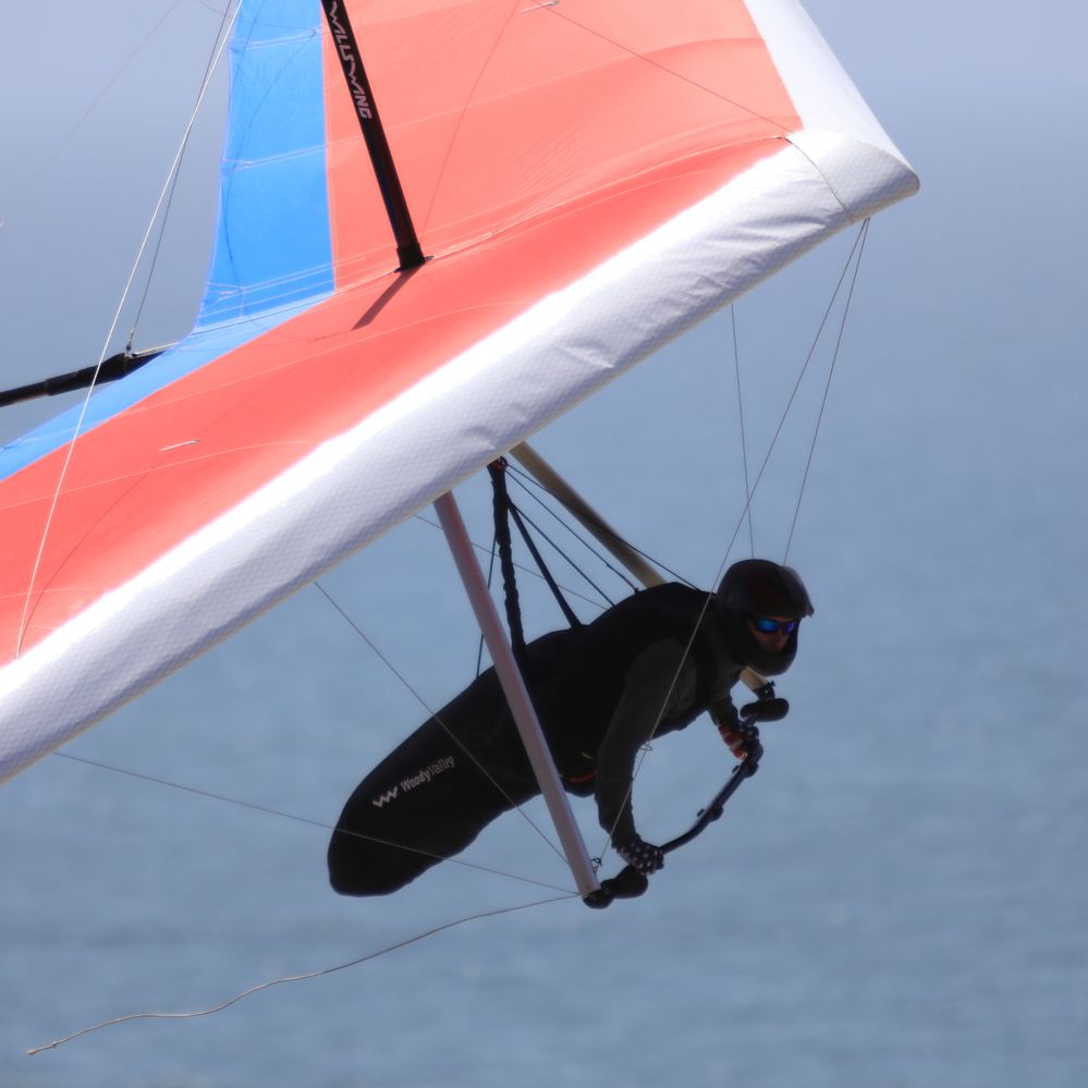

Thanks for all the hypothesis on this! I'm familiar with sharpness & diffraction at slow aperture and these are 100% crops.
The blur/mush/artifact is evident by simply zooming in 100% on the camera's preview screen.
