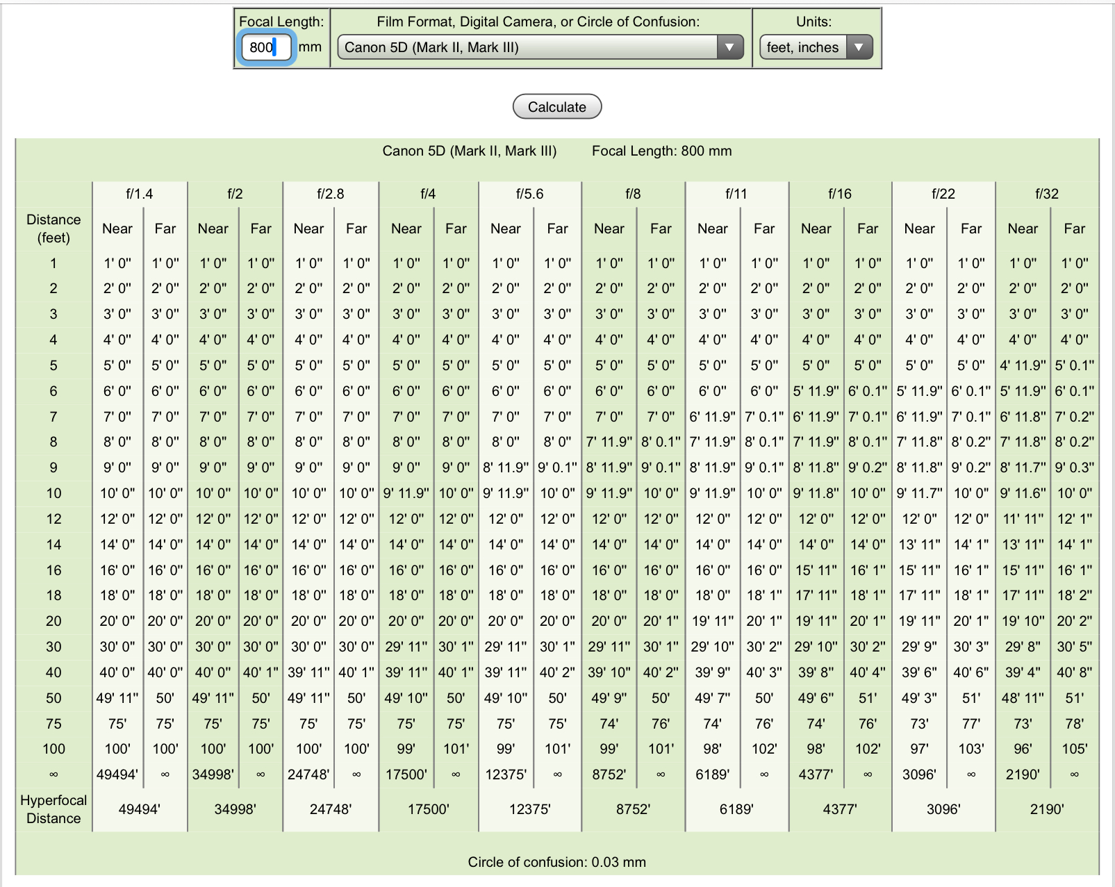

But, how far away was your subject.  Your DoF should be narrow.  Take a look at the DoF in the f/11 column at various distance to the subject.  It is pretty narrow.
I didn't see the answer to KV's question about how far you were from the subject but even at f11, the depth of field of an 800mm is very shallow unless you are a long distance away.

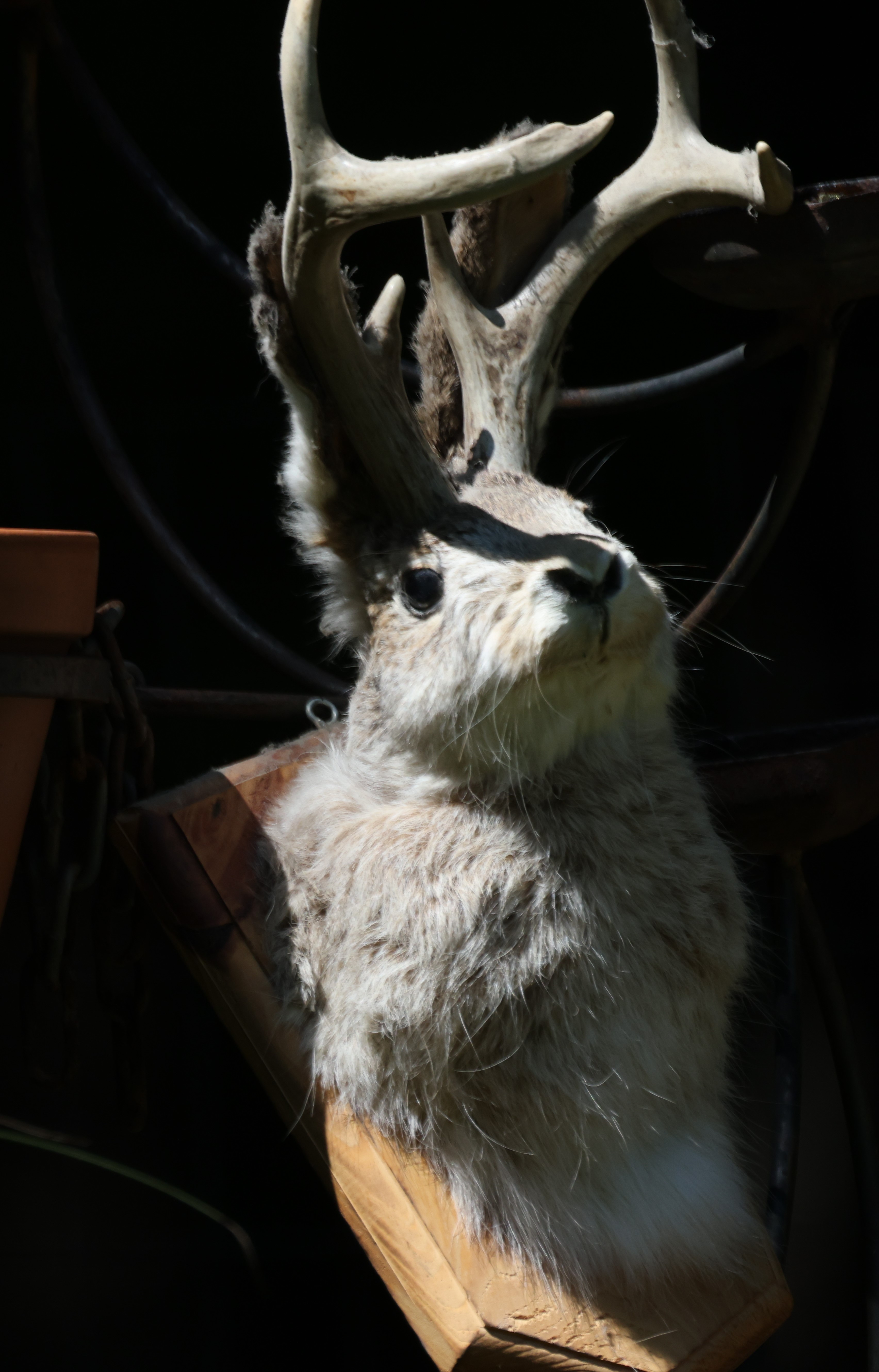

The attached photo was shot with an EF 800 f5.6 and EOS 1DX III at about 40 feet with a usable depth of field of around 2" and it shows.  Even at f11, the DoF would be under 5" at that distance.

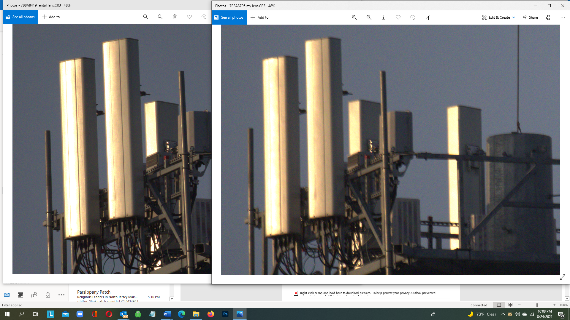

I was able to rent the same RF800 F11 IS STM lens from my local Unique Photo this afternoon and I did some comparison shooting.  The images I collected handheld of birds in flight were amazing.  I swapped the rental lens with my lens and took a couple of handheld shots for comparison.  I'll post them below.  The first is of a cell tower.  The image on left is the rental lens.  The difference between lenses is obvious, especially if you zoom in. Screenshot (407).png
