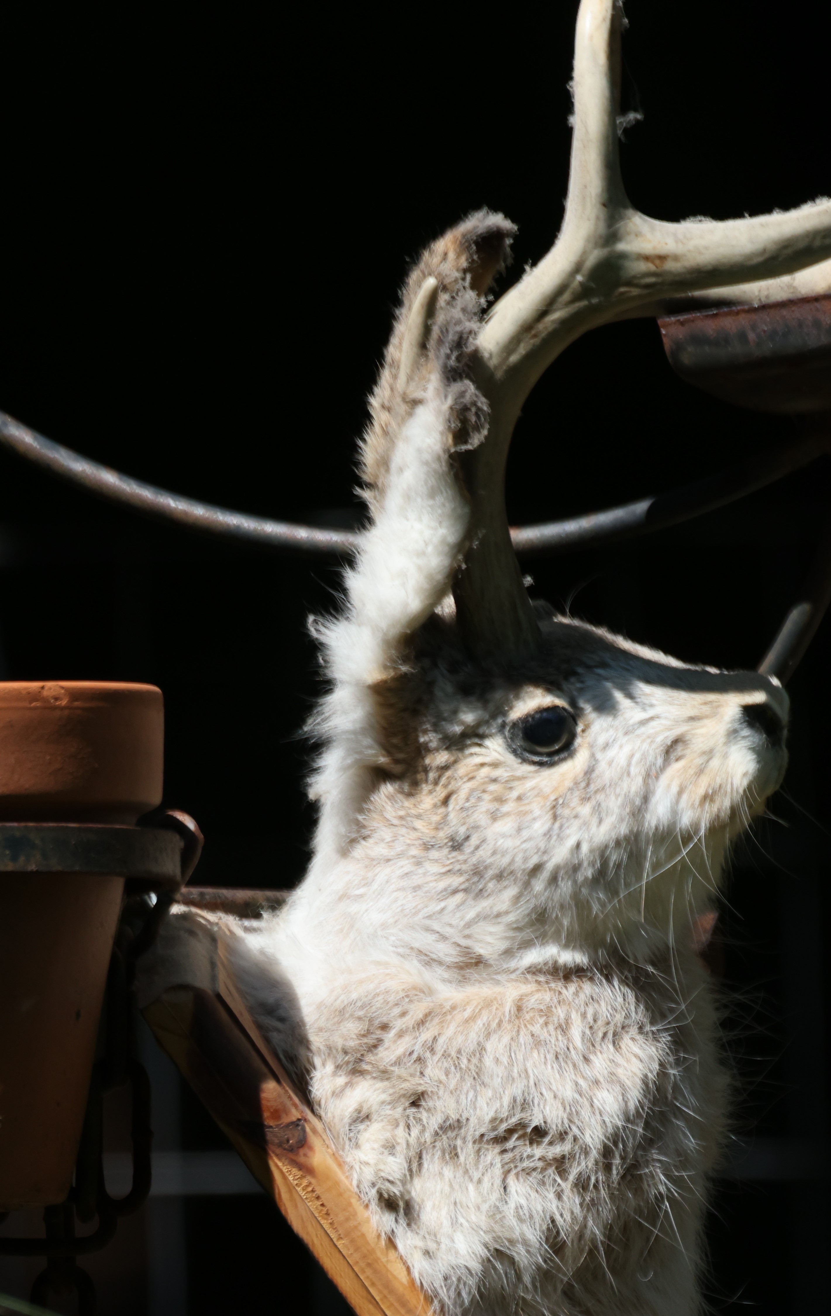

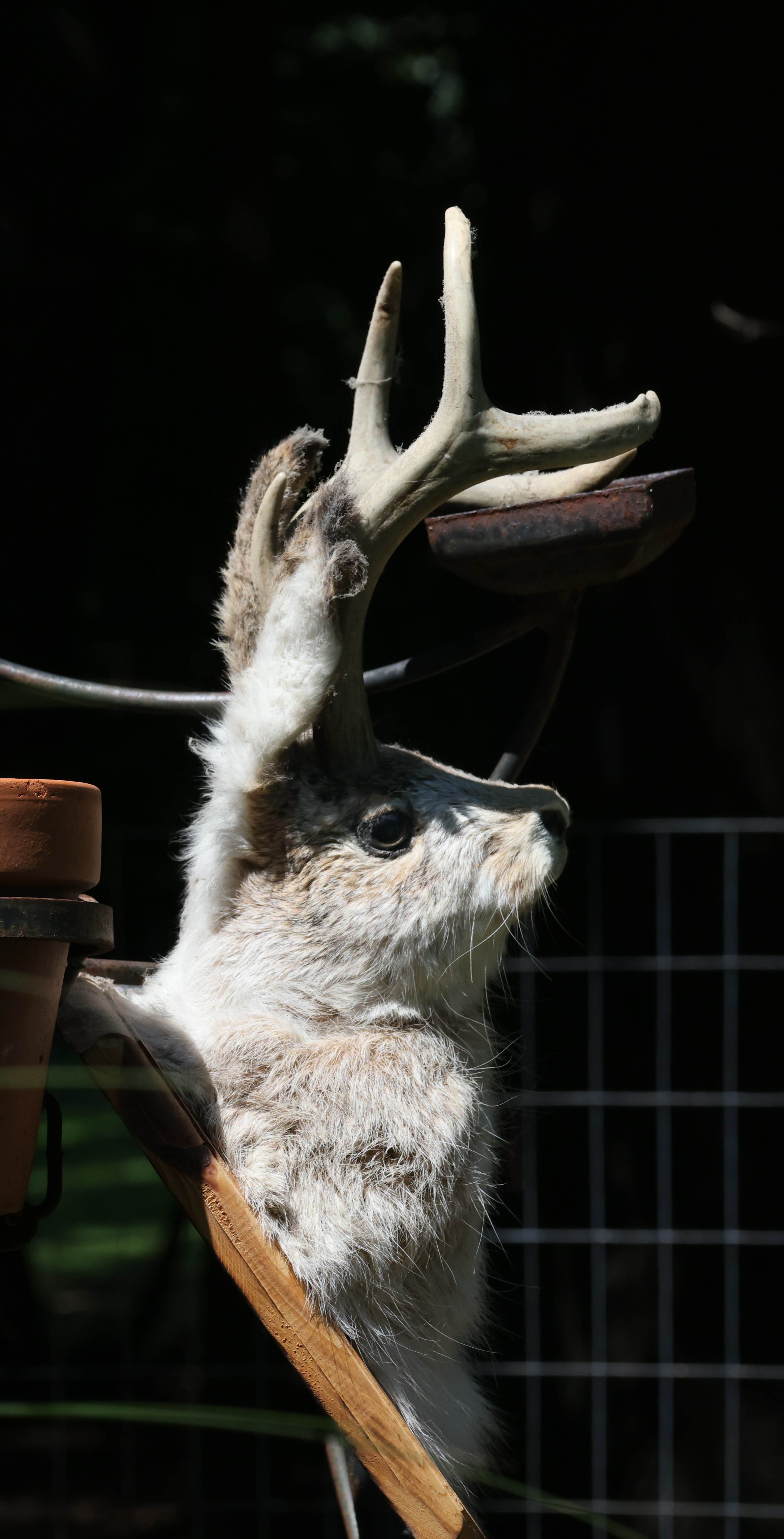

Hi, Thanks for your input. I am using the Animal Eye focus, which I have set up for back focus on the AF-ON button. I also have spot focus on the "*" button which I use if I can't get the animal eye focus to catch or if it is stuck on the wrong subject. Here is shot taken on a tripod of a very stil Jackalope. the specs are 8192 x 5464 (before crop).. size is 7.63MB, F11, exposure time 1/1250, iso 1250 also, Used the animal eye focus. In a post below I took same shot with R 24 to 105 lens and detail is great.

For comparisson, I just shot the same subject using my R24-105 lens at same settings at 105mm... just moved closer. Seems to show a lot more detail and better focus.
