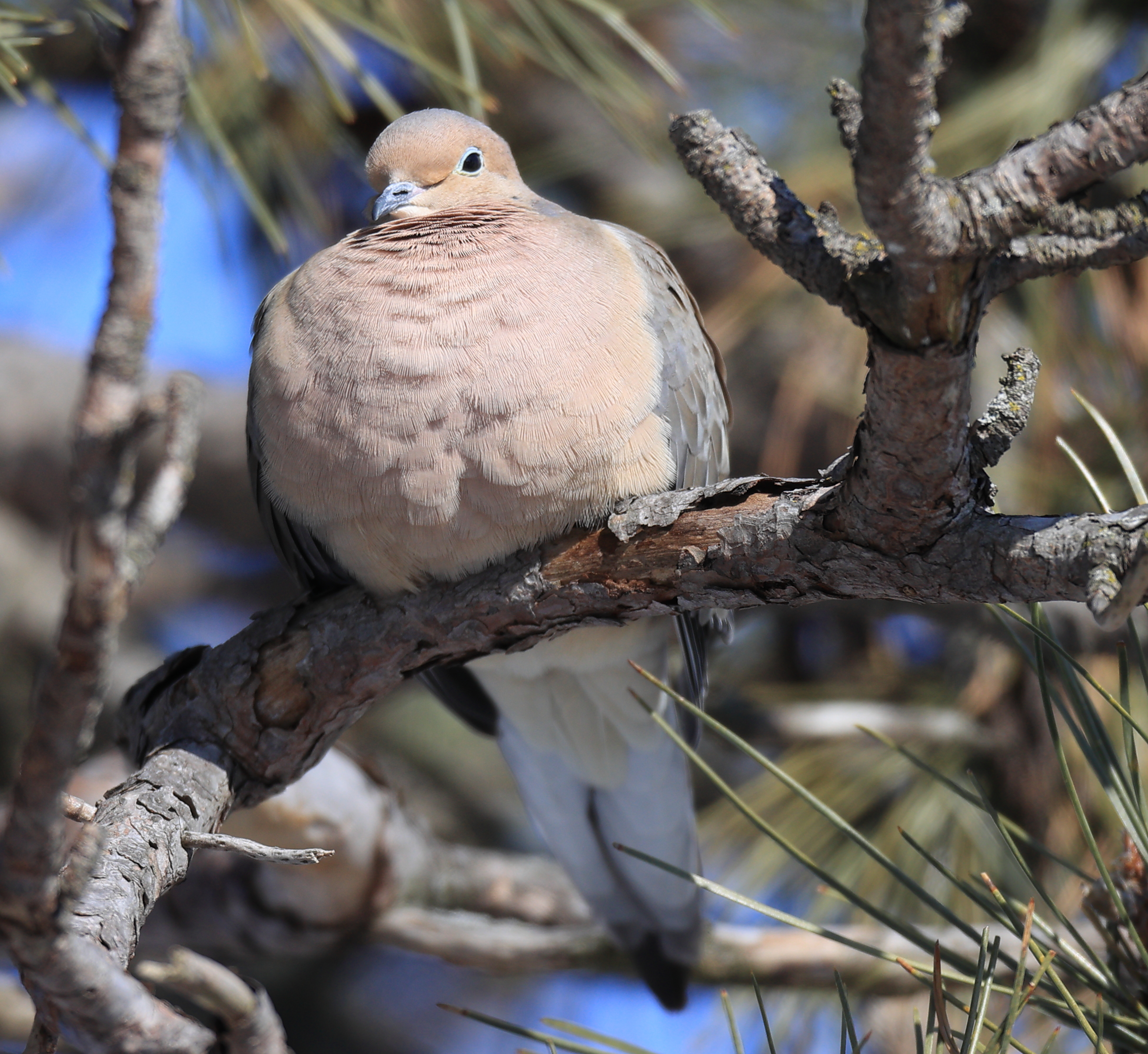

I didn't see the answer to KV's question about how far you were from the subject but even at f11, the depth of field of an 800mm is very shallow unless you are a long distance away.
The attached photo was shot with an EF 800 f5.6 and EOS 1DX III at about 40 feet with a usable depth of field of around 2" and it shows.  Even at f11, the DoF would be under 5" at that distance.
