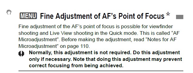

Your T4i didn't have autofocus microadjustment; your 5D3 has a particularly elaborate version that lets you set separate adjustments at the long and short ends of the zoom range. Try that before you give up and demand a replacement lens.

I want to help the OP too but Canon is pretty clear about not messing with the autofocus adjustment settings unless you're a pretty experienced photographer.
