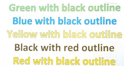

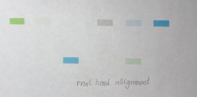

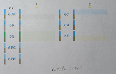

I have a pixma ip 8500 printer which started to print washed out colors. It happens even when printing text documents. I have  cleaned the print head and deep cleaned it. Then I cleaned the print head with warm water to unclogg it but the problem persisted. I have photographed the nozzle check, the printhead alignment check and a short text document to show what is happening. Any help would be appreciated.
As you see the green, blue, and yellow letters are washed out as is the black outline.
The black letters are also washed out, and the red outline renders as yellow.
The red letters render as strong yellow and the the black outline is washed out as well.
Thank you in advance.
