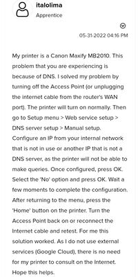

Hi,
Canon is currently looking into this issue and any updates will be posted on the usa.canon.com website.
06-01-2022 12:39 PM
Can you be a bit more specific? I am NOT a techie and you lost me. But if this is a permanent fix, I'd like it.
06-01-2022 12:53 PM
The link provides the workaround, but it is a bit technical ( configuring a fake dns server address). Can you just connect the usb cable to your computer instead of using wireless printing? It might be a simpler workaround

I found this in a different thread. Worked for me. All I had to do was unplug my Wi-Fi and the printer started right up, nevermind any of the other steps listed here... because that isn't sketchy at all, right Canon? What a weird coincidence.
06-01-2022 02:07 PM
Don't buy a new printer. Disconnect the Wi-Fi and the power will return as normal. I recommend wiping the settings, i.e., performing a factory reset using the printer menu, to prevent it from connecting again.
