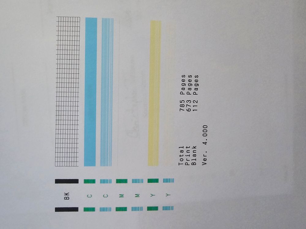

03-30-2026 04:10 PM
Here is an image from my print out. Would you still be able to assist? I need to be able to use this printer in my classroom!
Thank you!
03-30-2026 04:31 PM - edited 03-30-2026 04:33 PM
Are they genuine Canon cartridges? If not I suggest you change them, If they are I think the color one may be bad, Canon will replace it if notified.
