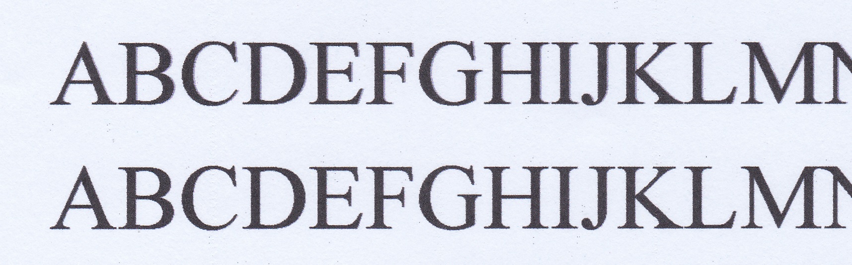

Even after cleaning the encoder strip won't help. I think main problem is printheads. Mostly of this problem come from Ink Tank inkjet printer. Where printheads used many years and some nozzle blocked by dust and dried ink when you not usiing many months or not using genuine ink. I got exactly this, but using E560 printer with CISS (continuous ink supply system) and ONLY when I using duplex printing. That why mostly inkjet cartridge won't get this problem but Ink Tank inkjet printer, where cartridge replace everytime you run out of ink. But my E560 printer use CISS, so it like Ink Tank inkjet printer. After 1 year setup CISS in my printer, shadow text starting getting worse. I tried many solution from google, but not work. So I just brought a new black inkjet cartridge, reinstall CISS and Print Head Alignment. Then it solved. Here is 2 line text before and after (Actually it worse than before but I only have this).
