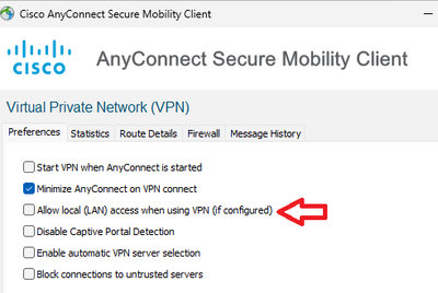

Hi,
If you are connected to a VPN, the printer is still connected to your wifi network and not the VPN. So when you go to print from the VPN it will not communicate with your printer.
You can check to see if that the “Enable Local LAN Access” setting is disabled in the VPN software when you go to print.

Greetings,
I haven't looked at Nord VPN specifically. Look for a setting called split tunnel.
Cisco calls it something different too.
