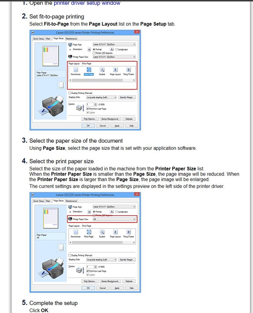

karsjensvalerie
INFORMATION FOUND IN ONLINE MANUAL:  If printing on roll paper, you can set borderless printing in the printer driver settings. (If printing on sheets, borderless printing is not possible) Prints without Edges Based on the Scenarios (Windows) Prints without Edges Based on the Scenarios (macOS).  My question now is what and where do I find "Scenarios"?
If the manual you are reading is talking about roll paper it is the wrong manual.
See here: Canon : Manuals : MG2520 : Select Device
