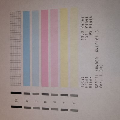

The nozzle check looks fine to me. See picture.
jrhoffman75
Then you need to check your printing path.
