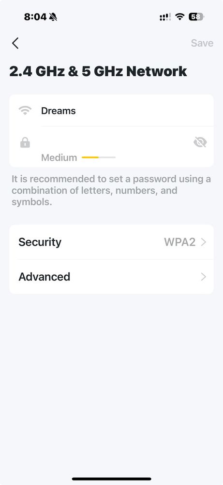

My router is TP-Link AX5000, which has two ethernet ports. Those are already occupied - one from the modem and the other to the ethernet switch to wired connection to other rooms. I already checked the wired connection works with the printer, but no avaible port in my router. This model supports both 2.4 and 5, both are enabled now.

I mean... my router had enabled both 2.4 and 5 already. I tried to setup wifi by manually and app, none of them worked.
