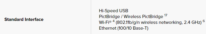

Hey there! Our printers can only "see" 2.4GHz WiFi. You'll want to see if there is a way to enable dual broadcasting on your WiFi so that legacy and IoT devices can see the network.
The other option is to hardwire the printer directly to your network by Ethernet (network cable), or to a computer by USB.
The following are the connectivity options on your printer:
