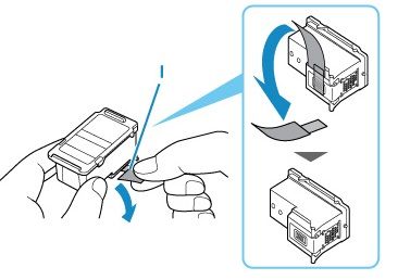

Please remove the ink cartridges and check for orange tape and remove it, if present:
