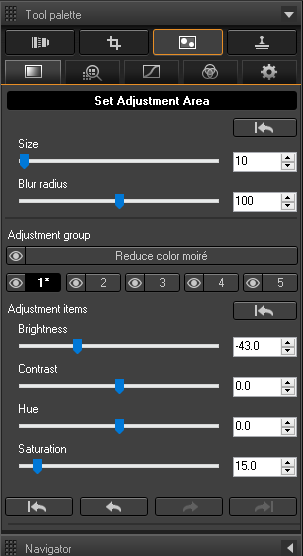

Hi All,
I have reduced Red-Eye in my images using DPP4.
Below is an image of the tool panel, with the settings I have used.
Once you have set things to suit your personal requirement, it's just a matter of painting out the Red-Eye by clicking and draging the mouse pointer over the specific area of the image that you want to affect.
I hope this helps.

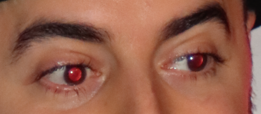

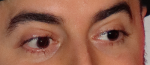

Here is a BEFORE and AFTER example...
BEFORE:
AFTER:
