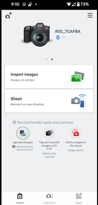

Unfortunately, I could not reproduce the behavior.
Bluetooth and Wi-Fi enabled on camera
Start connected to Bluetooth

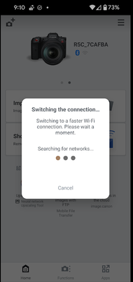

Press Import Images button.  App switching from Bluetooth to wireless

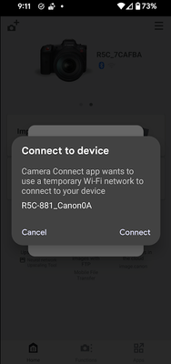

App automatically detects Wi-Fi broadcast on camera, tap to connect
App now connected to Bluetooth and wireless.  Images can be browsed and transferred. I also tested remote shooting.
