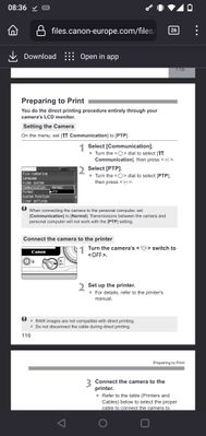

08-20-2023 02:37 AM
What if you change Communication from Normal to PTP or PTP to Normal?
08-20-2023 12:31 PM
Good catch. Some of the older cameras have that selection.
