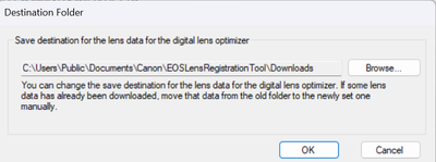

Press the Destination folder button. Note the path. (example)
Close the registration tool, EOS Utility, DPP, and the quick launch icon running in your system tray if you don't have it set to run on demand.
Now open this folder
Move the Lens Registration data to another folder (maybe one on your desktop). Run the Lens Registration Tool again. Select only those lenses you own. See if this works before connecting your camera again. If good, reconnect the camera and let us know the result.
