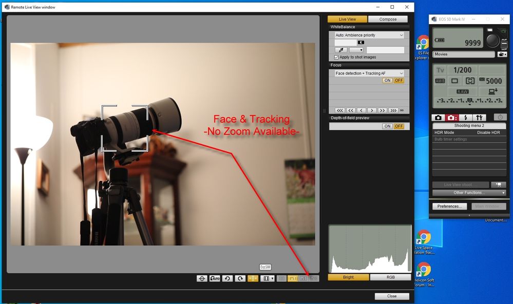

I am attempting to calibrate lenses for my EOS 5D Mk lV camera using the "Remote Shooting" function within the Canon EOS Utility 3 program. My laptop has Win 10 and am connected to the camera via USB. The utility starts up fine when the camera is connected and turned on. When I switch to "Live View" and focus on my target I cannot get the "x5" or "x10" (red arrows) zoom functions to work.

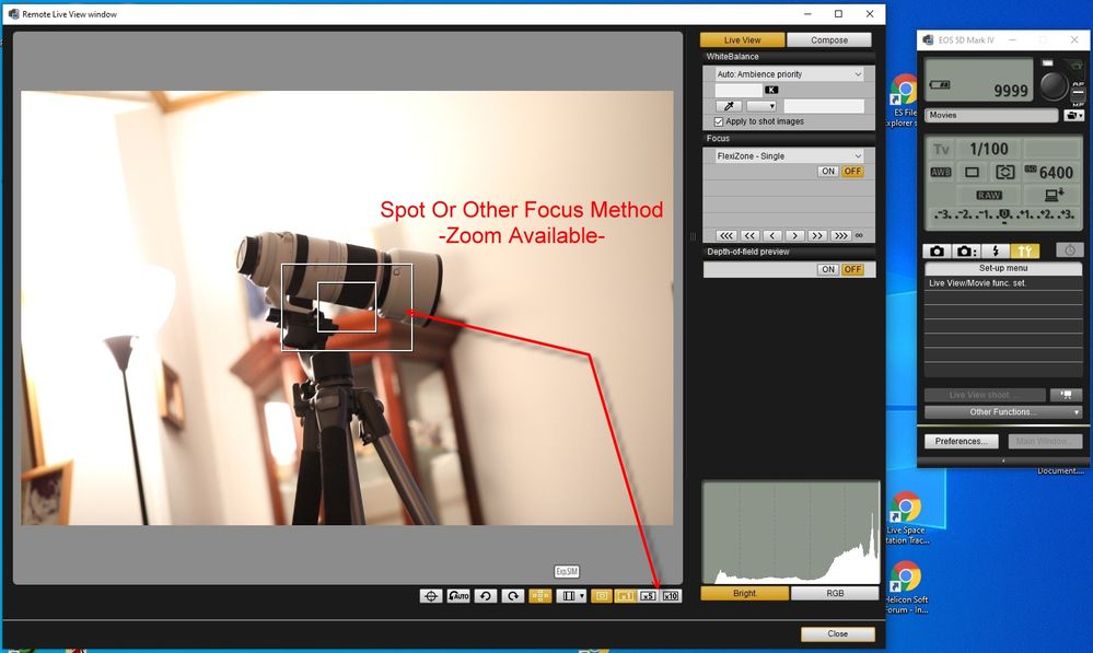

You have to be in another focus mode, besides Tracking/Face Detection before you will get the zoom feature in EOSU. Press the "Q" button while in Live View and select "Spot". I think you can use the pull-down and select "FlexZone - Single" in EOSU, but I didn't try that, so I just set it on the camera while I was doing remote shooting with the EOSU.
The images are just for reference so you can see the the difference in the appearance of the focus point/box.

Thanks a lot for all the help. The magnification function works now and the help you suggested did the trick. Much appreciated.     John A
