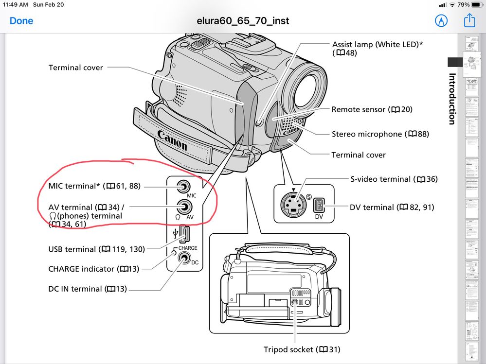

Thanks again for your response. I am attaching two images
which may explain the problem. The first is a portion of one you sent to
me. The second is a photo of my Canon Elura 60 depicting the same area.
It seems that my camera doesn’t have one of the outlets shown in the drawing
from the manual. At this point, I am looking to use the S-video connection which my camera does have to see if Incan extract sound and video. Thanks again. Ken

Well, AV is the one you need, anyway.
