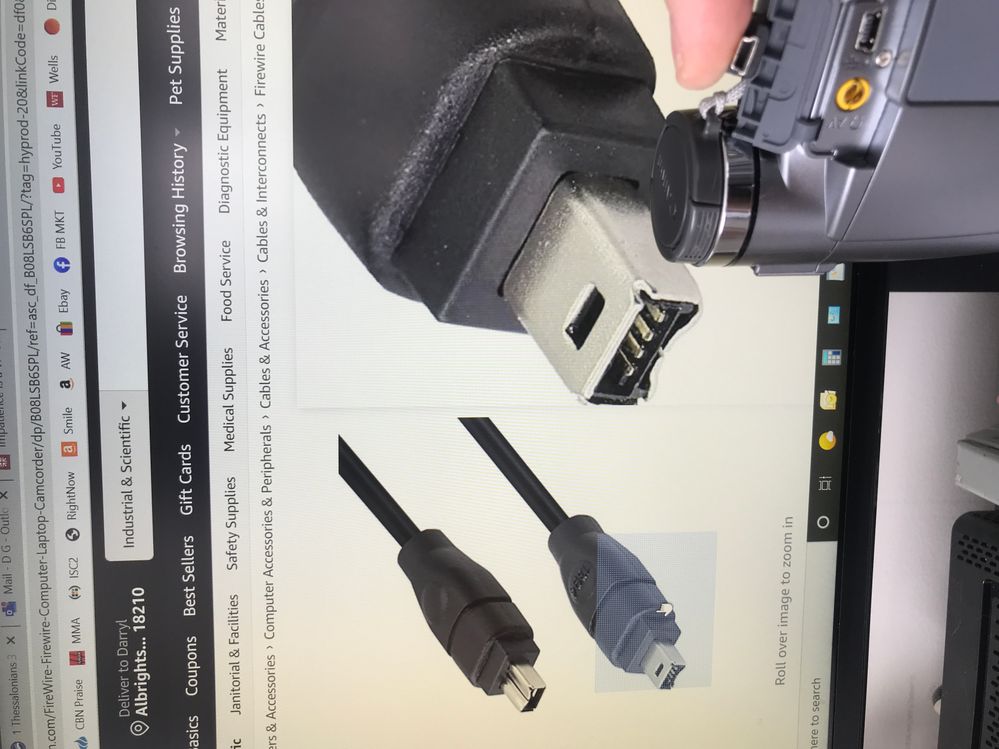

Nick,
As mentioned, the ZR85 camcorder's port doesn't appear to be compatible with a 4 pin firewire connector such as the Firewire 400 has. The connector on the ifc-pcu300 cable looks like it's a canon proprietary connector, and is wider on top, shorter on bottom . Here is a picture which shows the differences.canon ifc-300pcu connector compared to firewire 400 connector

Not to beat a dead horse, but if you look at the picture I uploaded, the firewire cable's connector on amazon has a square shape with a slight u on one side. The canon connector is like a T, wide on one side, less wide on the other. Definitely not a square. Take a closer look at the picture. They are two different shapes and don't look to be compatible.
03-13-2022 09:35 PM
Your photo shows three pictures of a Firewire 400 4-pin connector, and a finger on a USB Mini-B connector.
The USB Mini-B connection on the camera can only be used for downloading still photos. If you have the camera manual, read it. If you don't, here it is:

The picture shows 3 images of a firewire connector on Amazon.com (the 3rd being an enlarged image of the connector by placing the mouse pointer on one of the images) and my Z85 camcorder which has a USB Mini-B port, plus the Z85's ifc-300pcu cable's USB Mini-B connector. (Try holding a camcorder's cable connector next to it's port and taking a picture of a webpage with your phone) Thank you for telling me that it is a USB Mini-B connector. That's the first bit of information learned so far, as was already mentioned in the first post the manual calls the camcorder's port a USB Terminal which is not enough information.
I already mentioned in my first post the manual stated it can only download images. So the camera doesn’t have a firewire port, it seems. Is that true? Back to the original question of how can i connect the camera to a computer to copy the mini dv tape video to my windows 10 computer if it only has a USB Mini-B port on the camera? Thanks

Never mind guys. Apparently there is a cover I wasn't aware of on the front of the camera which has the firewire port. Thank you all very much!
