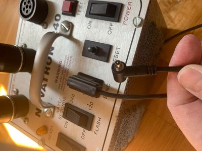

I have a canonEOS Rebel T3 and a Novatron 240 flash kit. I bought a Wein Hot Shoe Safe Sync and attached it by the proper cord to the light’s power box It isn’t tripping the flash bulbs. I don’t know what settings I need on the camera or is this just not going to work with this camera?

It might help if you show us photos of the of the various pieces you are using to make the connection.  I expect you are using a PC cord and they are notorious for causing connection problems.

Yes a pc on the Wein hot shoe end and a household plug into the Novatron end. I used the Novatron all the time with my Nikon SLR no digital. Everything turns on there— all connections are good and the bulbs flash when I push the test button on the power unit. The Wein recommends using an exact-o  blade to slightly expand the slots in the pc connector. I’ll send photos of all of the parts involved. The cord is new as is the hot shoe. Would a wireless trigger work?

 If the T3 can trigger a regular flash, what you have should also trigger the Novatron. You just need to find out where the bad connection is. Try shorting out the PC plug to make sure it triggers the Novatron. Also see if the Wein will also trigger another flash that has a PC connection.
Or try the same setup with another camera.

The pc did trip the flash bulbs. Since you say that stepping down the voltage between the T3 and the Novatron, is there another cord that has household prongs on one end but a connector other than a pc onto the camera— without the Wein hot shoe? Also, any chance the T3 has to have a speedlite hooked up to it to make the external flashes trigger?

The T3 does not need a flash in the hotshoe order to trigger a flash. You just need an adapter than can convert the hotshoe to a PC connection. The Wein “Safe Sync” circuitry might not be working properly with your T3. I would try a basic adapter like this one.
