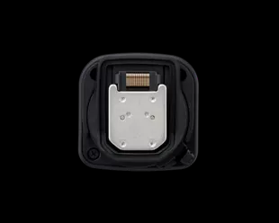

It's only compatible with newer cameras (R7,R10,R3,R6II) with multi-function hotshoe.
Per the product page: Important: Because of the transition to Canon’s Multi-function accessory shoe, please be aware that Speedlite EL-5 cannot be mounted or used on Canon cameras with other accessory shoe designs.
Also in the tech specs: Compatible Cameras EOS cameras equipped with a Multi-purpose Shoe

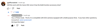

12-02-2022 07:39 PM
For what it is worth CanonUSA did confirm that the R5C is compatible (in Photo mode) in the comment section of the EL-5 Youtube video:
12-02-2022 08:16 PM - edited 01-05-2023 11:22 AM
@xnowrote:For what it is worth CanonUSA did confirm that the R5C is compatible (in Photo mode) in the comment section of the EL-5 Youtube video:
https://www.youtube.com/watch?v=ZOrFhFtU_p0
I guess we can put this to rest.

Canon's website info is not always accurate, or up-to-date. Checking the info about various lenses and compatibility with extenders, there's a lot of misinformation there.
Regarding the new multi-function foot and shoe, I can confirm the following:
The Speedlites and the ST-E10 transmitter, with the new multi-function foot, will not fit or work on any camera without the new shoe, i.e. with a conventional hot shoe.
Speedlites with a conventional hot shoe (hot foot?) will, however, work on a camera with the new multi-function shoe. It is not necessary to use the AD-E1 shoe adapter. However some speedlites with rubber seals for moisture/dust protection, such as the EL-1, when fitted directly to a camera with a multi-function shoe, will not be protected because the seal doesn't fit. That's what the AD-E1 adapter is for - it provides a surface for the seal to mate with, thus retaining the moisture/dust resistance.
