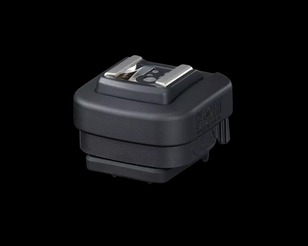

Regarding the new multi-function foot and shoe, I can confirm the following:
The Speedlites and the ST-E10 transmitter, with the new multi-function foot, will not fit or work on any camera without the new shoe, i.e. with a conventional hot shoe.
Speedlites with a conventional hot shoe (hot foot?) will, however, work on a camera with the new multi-function shoe. It is not necessary to use the AD-E1 shoe adapter. However some speedlites with rubber seals for moisture/dust protection, such as the EL-1, when fitted directly to a camera with a multi-function shoe, will not be protected because the seal doesn't fit. That's what the AD-E1 adapter is for - it provides a surface for the seal to mate with, thus retaining the moisture/dust resistance.
