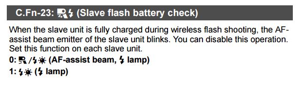

I am using 600EX-RT speedlites off camera controlled by the ST-E3-RT Transmitter. How do I disable the Wireless Remote Ready Light that is flashing red on the front of the speedlites when they are in slave mode?
I have already used C.Fn-08 to disable(1) the AF assist beam but that did not resolve the issue.
Hoping that someone has a better solution that the gaffers tape I am about to apply to the speedlights.
Thank you
10-07-2016 07:01 PM
Did you try setting this option? Set it to 1
10-07-2016 07:28 PM
Thank you Diverhank. That worked. I'm guessing that by the time I had read that far down the list my brain had shut off...
