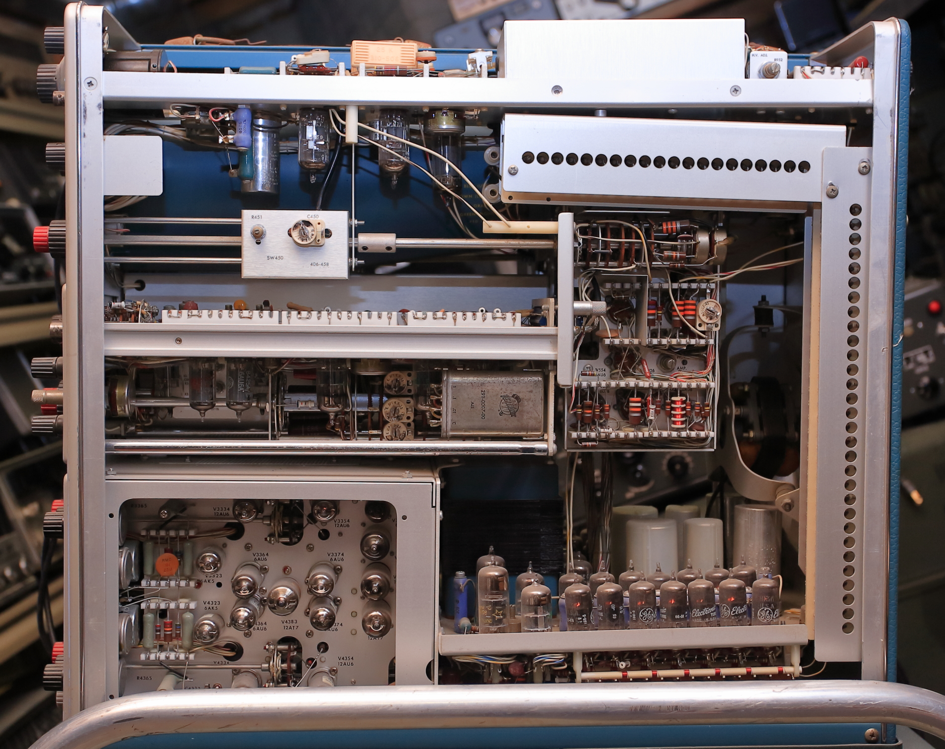

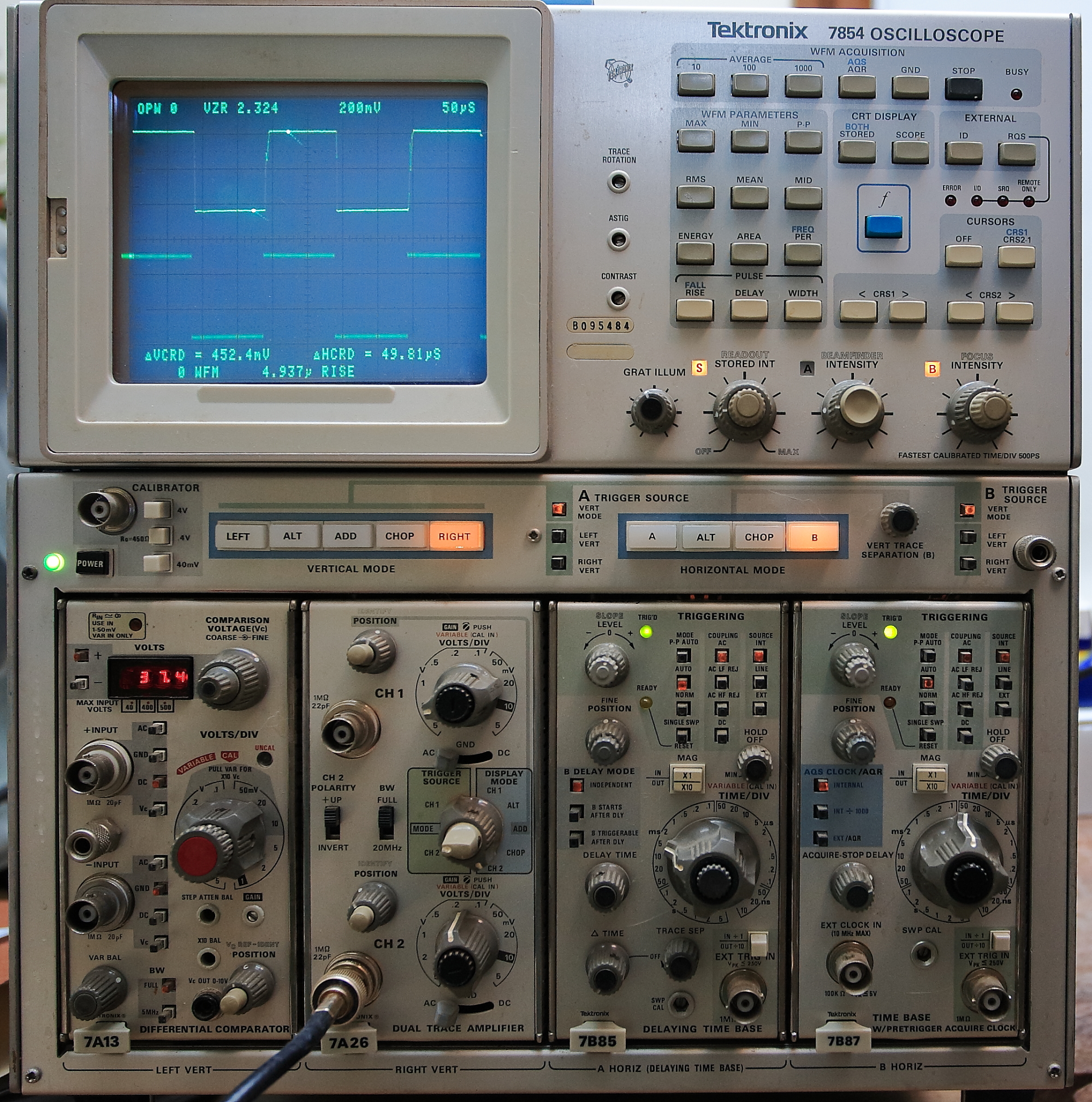

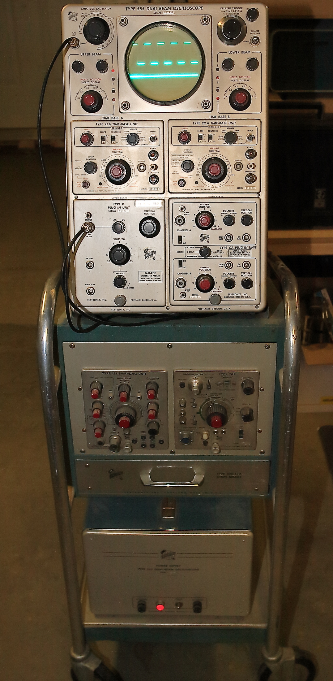

The big Tektronix tube type scopes really do generate some heat. I restored a Type 555 which is a true dual beam scope with twin gun assemblies in the CRT. It and its external power supply each have their own large cooling fans and reside on their official Tektronix Scope Mobile cart. I believe that it draws close to 15 amps in operation. Although it still works perfectly, not surprisingly since Tektronix design and construction quality are both works of art, I primarily use a pair of slightly newer solid state Tektronix 7854 scopes on the bench. They are hybrids providing both standard analog operation along with a digitizer with both recursive and one shot capture allowing waveform analysis and storage. The Tektronix high voltage probe in the last photo allows safe measurements of waveforms up to 40,000 volts and keeps the operator at a safe distance from the measurement point.
And for anyone who complains that it can be tedious dialing in a Canon lens with the micro focus adjustment, they should try aligning the delay line on a vintage Tektronix scope. These delay lines consist of a large series of adjustable inductor/capacitor pairs and provide a very slight delay between the trigger pickoff point and the distributed vertical amplifier so that the scope can display the actual event that triggered the timebase. The trick is providing this slight delay without altering the original waveform and proper alignment usually requires at least 5 complete trips through the entire line; the adjustment holes for the delay line are visible in the interior shot and reside in the L shaped covers around the outside area of the scope frame. Since it is a true dual beam scope it has a separate delay line for each channel so there is a duplicate on the other side of the scope providing for twice the "fun" during calibration 🙂
