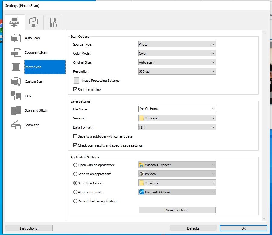

I understand, we all have our favorite programs and are used to the way they work and it's frustrating to pop it open with a new device and stuff just... is gone. I was a little lost when I bought the LiDE 400 trying to use it's utility. But, it didn't take long to get it to where I wanted. Try the Canon IJ Scan Utility that came with the scanner, it may work for you. It has cases that you can modify, then once it's set up you just click the case or press the scan button. I really didn't like it at first, but it didn't take long to get to know it. Attached is what you see when you click "Settings". I hope this helps.

Thanks. I did try Canon's IJ Utility tonight and it does work although, in my opinion, not as well as "Image Capture". I was surprised to discover that if I put 4 photos on the scanner, it did a good job of autodetecting and scanning each. It would be nicer if there were a preliminary "overview" scan to look at before initiating the actual scan just to make sure that the image margins for one or multiple photos were accurately detected. It seems that now the only way to know if the results are satisfactory is to open the images after the scan is completed. It seems more efficient to be able to check that before the actual scan is done. I compared scanning the same photo using Image Capture with the LIDE 220 and LIDE 400 scanners and then with the LIDE 400 scanner using Canon's IJ Utility. The resultant TIFF files sizes were as follows:
If you know of a way to see a preview scan with the IJ Utility or some way to know beforehand whether the IJ Utility has accurately detected the margins of multiple individual photos placed on the glass, please let me know. Thanks again for your input.

I totally understand. I was used to getting a preview with my HP utility which had some additional adjustment abilities, so I really miss that. Now what I do, if scanning multiple pictures at once, is tic the "Open with an application" selection and send the scans to PSP 2021 for preview, then editing and saving. As you've seen, Canon IJ Scan Utility does a really good job at separating the images and aligning them, I've even put pics on the plate cocked bad. It's just lousy at allowing you to do anything "pre" with those tiny thumbnails before the final scan.
That's the way I deal with it and it works out for me because I'm going to edit them anyway. If I'm pressed for time, I just batch save the lot and deal with them later. I do a lot of photo restoration.
