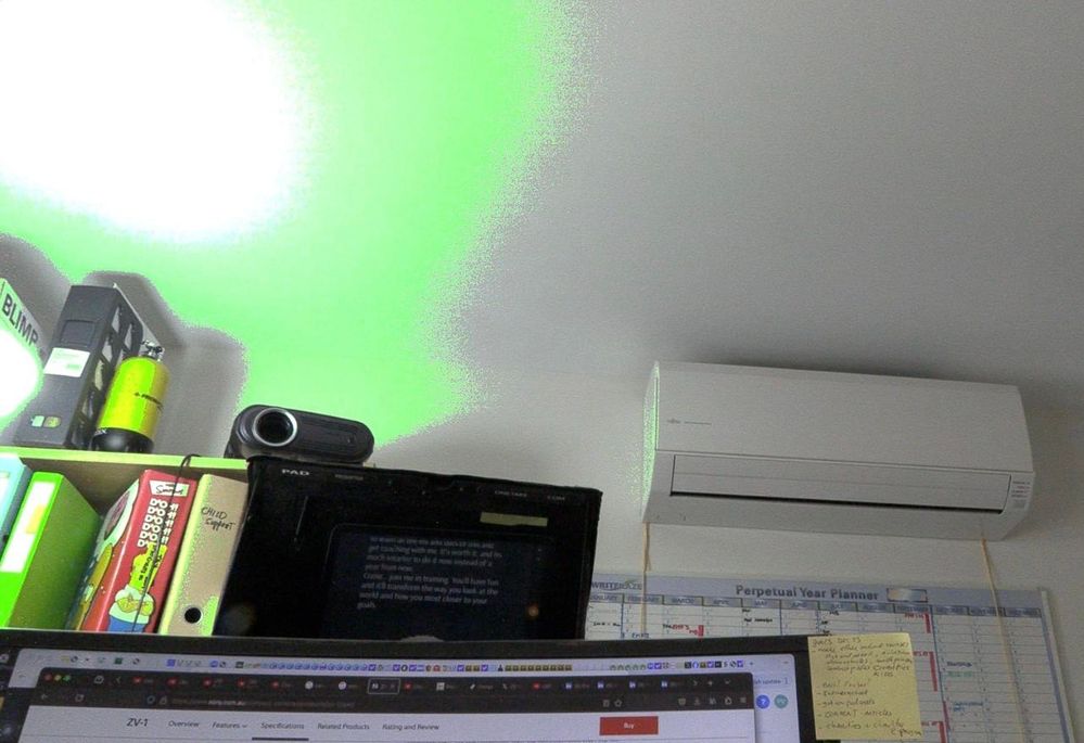

I've been having this issue since a month or so. After some experimenting it seems that the a certain zone of lighting ends up being green. First I though it was the areas overexposed that were turning green, a bit like peaking, but on closer inspection, it is not. As you can see in this photo the far corner is the brightest zone and it is the zone slightly darker that has turned green and then it goes back to normal colours where it is darker still.
If i adjust the exposure darker, the zone starts disappearing.
Also the picture in general seems to be more grainy.
Did a reset to defaults but that didn't help.
Camera is a few years old now. Mostly used inside for webinars nowadays.
Couldn't find any help on the internet looking for Canon XF400 green colour troubleshoot, but found this page so thought I'd add. Anyone fixed this?

There is nothing you can do except send the camera to Canon - they will charge you around 950 dollars to fix it. They told me they have to change the sensor or something like that. I gave up on the camera and switched to Sony.

Greetings,
I suspected a sensor failure. A green tinge that is uniformly across the entire frame can be lighting. Usually it manifests itself like a mask or transparency. When it's not uniform, its almost always the sensor. Rarely its power, the memory card or storage media.
Warranty duration varies by country and region. I'd arrange for inspection and repair. This way you can find out what's wrong and see what your options are.
