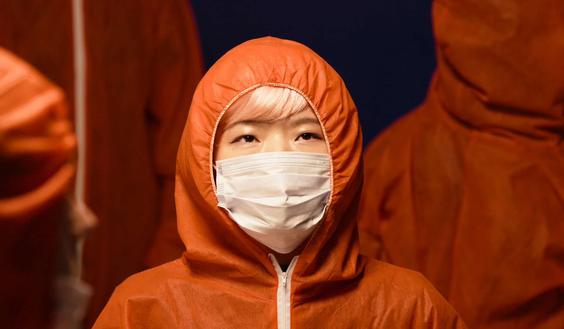

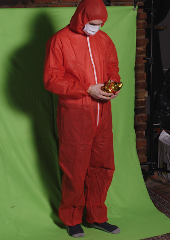

02-18-2021 01:08 PM - edited 03-09-2021 06:57 AM
Hi Canon,
I have the exact same problem and it's killing me. I've shot 100s of plates on Chroma Screen of all my characters in Red costumes, but the costumes are coming out Orange. The white balance is OK, it's just the red and skin tones - so weird.
And I know something is wrong, because today I shot using the exact same camera, a few months later, with a different light source and now the footage is perfect, the same costumes come out Red.
Please, please tell us the fix, as I don't have the money to pay a professional colourist to fix and mask 50 shots/100 plates? I feel like it should be an easy fix, perhaps there is a Canon LUT you can make?
Best,
Robin
PREVIOUS FOOTAGE - INCORRECT ORANGE
NEW AND CORRECT
