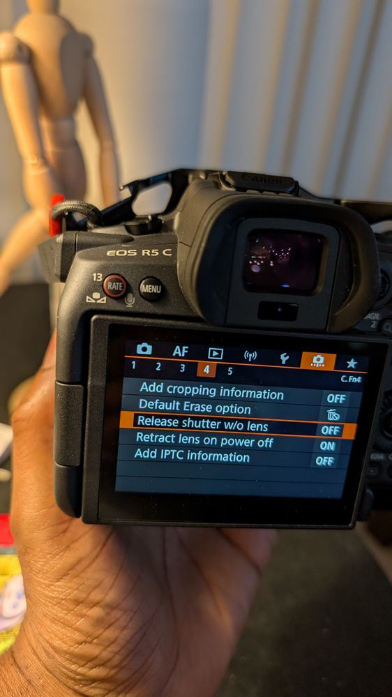

I own the Canon R 6 Mark II and l am able to take pictures with Manual focus only lens, l had to enable an option using the custom function menu function.
I recently acquired the Canon R5 C for cinematography as well as photography and l cannot find the same function, and so far l can’t take pictures with this MF lens but l can record videos. Can anyone let me know where  to enable this on the R 5 C, l can’t find this on the cameras photo pdf documentation. Thanks
Lens: Rokinon RF mount full frame Cine 85mm T1.5.

Greetings,
Photo Menu:
The Release Shutter w/o Lens option is found on the C.Fn4 menu

infinityone
Thanks. That worked perfectly. I’ve attached screenshots in case someone else has this issue.1000007741.jpeg1000007741.jpeg1000007742.jpeg1000007742.jpeg1000007740.jpeg1000007740.jpeg
Yes, l just need to find the menu option on the photo mode. A solution was provided for this. Thanks
