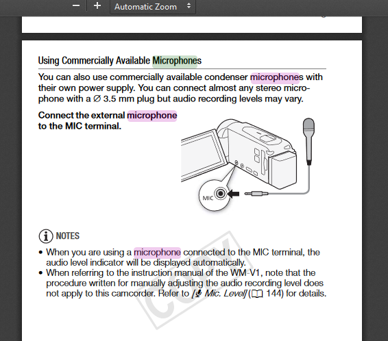

I think the Vixias all require a self-powered external microphone to work properly, just in case you're trying to use an unpowered mic. Plugging in any mic will disable the onboard microphone.

According to the user manual, it appears that it's just a matter of plugging in any self powered microphone with the right size jack. Are you trying to use an unpowered mic?
