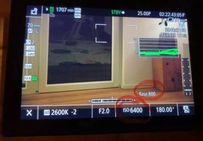

Thank You for the answer, this thing with dual ISO I think that I understand my issue is that I don't understand why in R5C I see two ISO value one is Base ISO and another is the work iso of the camera. Please see the image. Base ISO is set to 800 and under is 6400. The 6400 I can change and the 800 is still visible.
09-05-2023 12:31 PM
You can definitely dial in whatever ISO you need. The base ISO is there so as to provide the ability to maximize the amount of dynamic range captured.
e.g. when using a base of ISO 800 and you keep your ISO at 800, your footage would have the highest amount of dynamic range. You may still get the same range as you lower or raise that ISO a bit (you'd have to find charts that would reference that). However, once you approach ISO 100, the dynamic range will most likely be lowered. Same when using high ISO values. And of course with the higher ISO values, you'll have extra noise as well.
