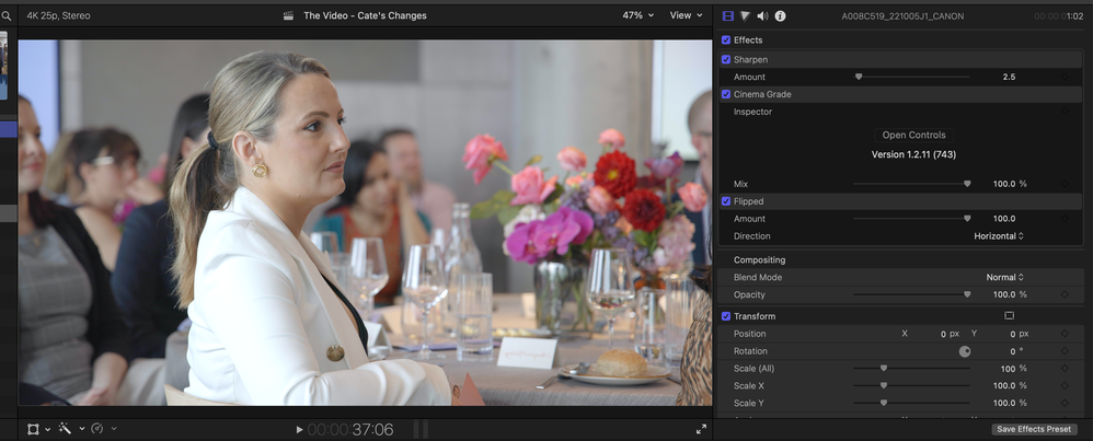

Secondly, when filming in DCI 4K 50p on the R5 C and putting it into a DCI 4K timeline (4096 x 2160) with the 5D Mark IV footage, I get an annoying white line (about a pixel wide) around the footage. I have to zoom in to 101% on the R5 C to avoid getting this border.
Has anyone else experienced these issues?

Here is an example of the issues I am talking about.
1. The difference in audio level from the R5 C and the 5D Mark IV.
2. The white border I am talking about. It disappears when I zoom the footage in to 101%. White border disappears when zoomed into 101%.White border disappears when zoomed into 101%.Audio level difference in the 5D Mark IV and R5 C (with built in microphone)Audio level difference in the 5D Mark IV and R5 C (with built in microphone)White border on the left and right of frame at 100%.White border on the left and right of frame at 100%.
rs-eos
Is the white border part of the actual footage? I notice that the viewable area with the footage is set to 47%.  Perhaps there's a drawing bug in Final Cut?   If you view the footage at 100% and pan to the left and right edges, do you still see the issue?
Ricky
Thanks for the quick reply Ricky.
Yes the viewable area is 47% but is set to 'Fit'.
I have zoomed into 100% and yes I still get the issue. See screenshots below. (1 is with the scale set to 100% where you can see the white line and the other set to 102% where the line disappears).
I have attached an image below from the video that has been exported and you can see the white line in the final export .mov file too.Screen Shot 2022-11-04 at 11.48.49 am.pngScreen Shot 2022-11-04 at 11.49.00 am.pngStill from the exported .mov file. White line still visible on the left and bottom.Still from the exported .mov file. White line still visible on the left and bottom.
