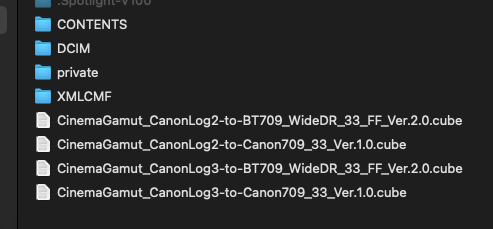

I can't seem to register LUTs in this camera. The "register" option and everything else on that menu is grayed out. And yes, I have .cube LUT files on the formatted SD card.

I got the LUT folder from the Canon website. They seem to be broken down into 3 groups, but not sure what "65grid," 33grid," and "17grid" means. I did manage to regsiter one of them.

Have you tried loading them on your proxy SD card? Canon's 33 grid are the ones to use, even the new Canon 709 & CMT 709 LUTS should load. I don't have C300 MK III but C700 FF. LUTS should be at the root level, like in screengrab. Hope this helps? Charles

The problem was I was trying to load the 65grid lut instead of the 33grid lut. ChatGpt told me (even argued with me) that the 65grids are compatible with the camera. After trying over an hour, I asked Gemini and it told me the 65grid isn't compatible with the camera and to use the 33grid lut. the 33grid worked the first time.
