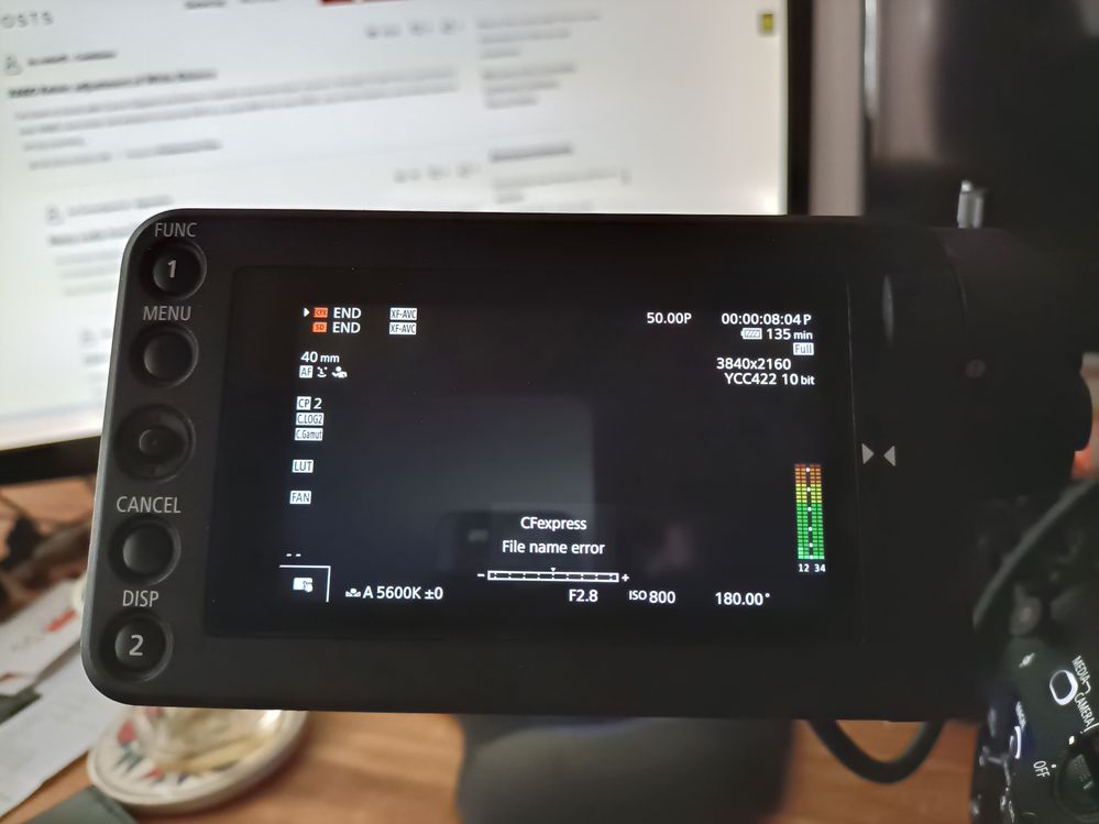

I experienced a "CFexpress File name error" for the first time while shooting with my Canon EOS C400, and I wanted to know if anyone has run into this issue and found a workaround that doesn't involve reformatting the card on set.
How to reproduce the issue:
Reach clip/file index 999
Start & stop recording (next clip fails to generate)
I tried changing the Camera Index and Reel Number in Recording/Media Setup > Metadata and set Clip Numbering to Reset, but none of these changes had any effect.
Formatting the card obviously fixes it, but that is not a viable option during a client shoot. I don't have time to stop, back up, format, and reconfigure settings mid-take.
I used to have a similar issue with my C300 Mark II and was hoping it would be resolved by now (via automatic reel incrementation or similar), but it seems it hasn't.
Is there a way to fix or bypass this in-camera during a shoot without formatting?
Thanks,
Julien
Before recording
During recording

Greetings,
I looked at the manuals for the C400, R1, R5 mkII and my R5 C. All have the 999 clip number limit.
The only way I found to resolve is to format the card, delete clips or switch to a different card.
You may want to reach out to Canon support to see if they have any recommendations. 800-652-2666.
