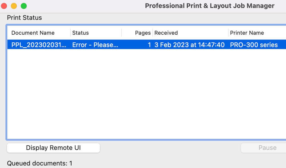

I wonder if you could help, I have a Mac studio M1and have been trying to print my images all day but with no luck, first using photoshop but I get a strong magenta cast, I guess I'm double colour profiling but can't work out how to stop it in Photoshop 2023, the dialog box for print settings doesn't give me any options.
The I thought I'll try using the PP&L software but I get an error in the dialog box and no communication between printer and computer appears to happen.
Following the thread I checked in the Printers & Scanners tab to see if the printer was selected which I knew it would since photoshop connects to the printer but unlike the other people in here my driver version says 3.0
Hope this all makes sense and someone can help.
Thank you

If your driver says 3.0 it is the Apple AirPrint driver.
Go here: Canon Support for imagePROGRAF PRO-300 | Canon U.S.A., Inc. and download the CUPS driver.
After you download install the driver and then go to Printers & Scanners. Add the printer, waiting for the IJ Series to appear.
