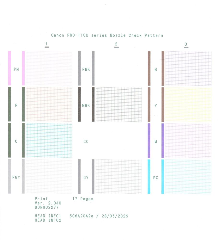

05-31-2026 07:56 AM
After countless tests with papers and ICC profiles, I finally found the problem.
A nozzle check showed that the Canon wasn’t printing any PBK or CO. A cleaning cycle fixed it, and now the prints finally look good.
I feel pretty stupid for not thinking of that right away. 😣
05-31-2026 08:23 AM
Unfortunately, it looks like the problem wasn’t actually fixed by the nozzle cleanig.
I printed an image and after about 90% of the print, black (PBK) dropped out again.
Another nozzle check confirmed it: PBK and CO weren’t being printed anymore.
I will try the "intensive cleaning" but then I’m slowly running out of ideas.
