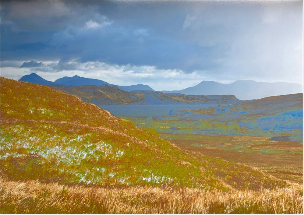

I’ve attached a scan of a print on "Photo Glossy 260" paper and a scan of a print on cheap office paper for comparison (with the "Plain Paper" option in "Canon Professional Print & Layout").
On the print on "Photo Glossy 260" the colors look extremely unnatural and washed out, with strong yellow‑orange and cyan color shifts. Also visible banding, especially in the grass and building areas.

I started another test because I thought the Hahnemühle ICC profile might be the cause.
However, I’m seeing the same problem with the Canon paper. I used the A3 sample paper that came with the printer (Canon Photo Paper Pro Luster).
I selected the media type and ICC profile according to the instructions on the package.
Unfortunately, the result still looks terrible.settings for Canon Photo Paper Pro Luster
print on Canon Photo Paper Pro Luster
original picture
