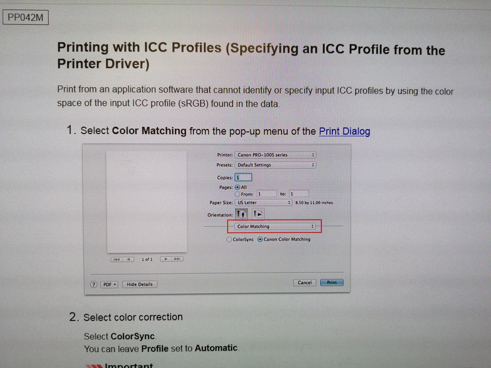

xrischan
The ICM colour setup is in the printer driver window in printing preferences.
xrischan
Na, Na
We shouldn't be making adjustments by eye.
Your room lighting will affect the resulting print. Try taking it outside and see how it looks.
As far as I can see Print Shop Pro is there to avoid conflicts with PS and driver colour management.
I don't use it. As I have my drivers all set up to use the ICM made when profiling.
Try a print through PS with Printer Manages colours selected.
Under print settings you should have colour settings
And somewhere in there you should have ICC Profile Matching.
I have my rendering intent set to relative colour metric in both the driver and the PS print dialog.
Try that and see how you go.

Infact, here is a link to the manual, just in-case you havent read it.
https://ij.manual.canon/ij/webmanual/PrinterDriver/M/PRO-100S%20series/1.0/EN/PPG/dg-c_color_correct...
