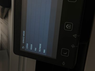

I’ve seen this procedure referenced on Reddit, along with the following variation that seems to work for the MF632Cdw:
  • Press Home
  • Press the blank space between Sleep and Home
  • Press the blank space betwen Home and Stop
  • Press the volume button
  • Press stop — at this point, the device should display a SERVICE MODE menu.

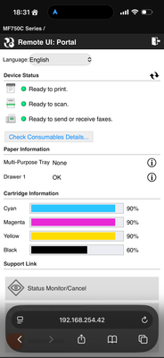

Update 1: I figured out my remote access username and PIN. Still no clue what the System Manager ID and PIN are that I set lol 😞

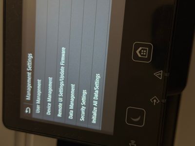

UPDATE 2: 800 attempts of the two procedures later, I finally got into SERVICE MODE!
Went to COPIER -> FUNCTION -> CLEAR -> ALL, and the PIN was cleared + I could access the Management Settings menu to do the needful.
It pays to never give up, lol! The “second” procedure (that there is video evidence of working on the MF653Cdw) is what worked for my MF753Cdw.
