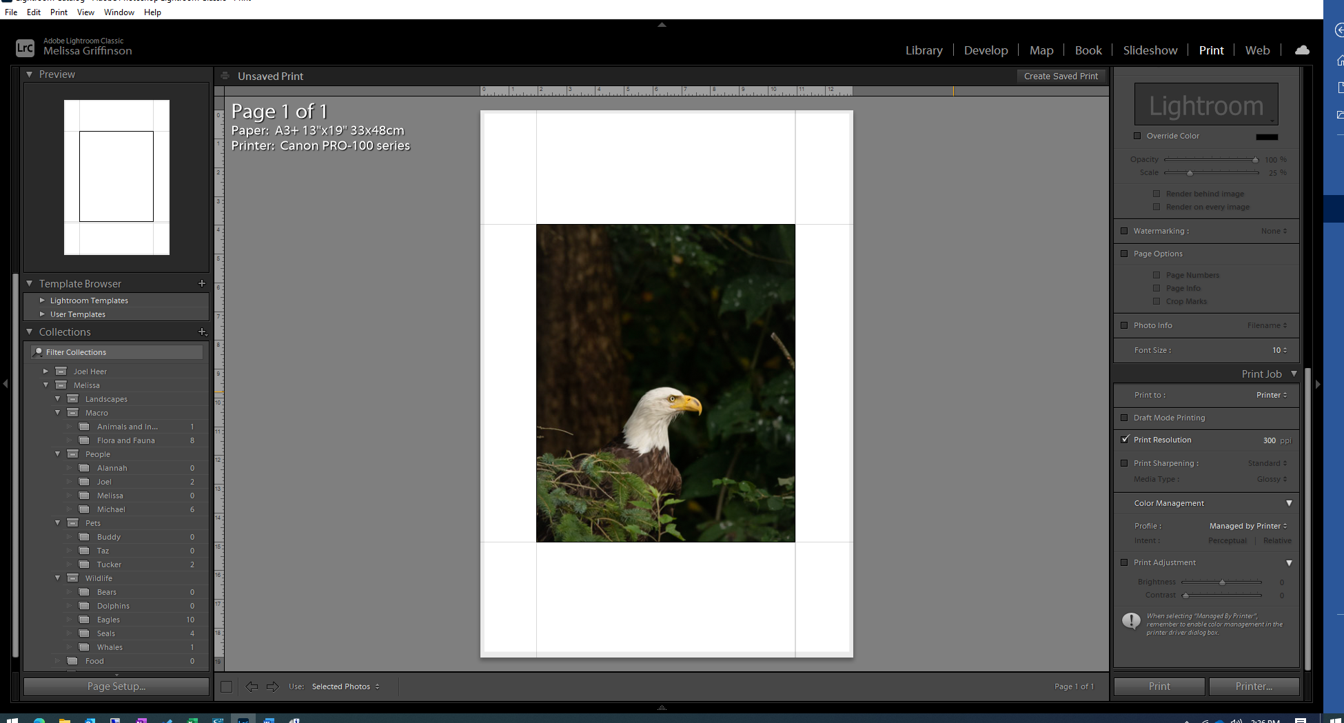

The other thing I do, since I sometimes use third-party papers,  is use Lightroom to manage color as a standard workflow.

In lightroom you are using printer to manage color. Try to manage color by icc, set the driver color management to none and the driver is right/updated  Schermata 2021-01-11 alle 23.38.52.png
