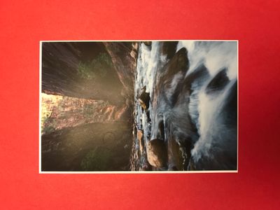

12-18-2018 09:29 PM
I followed your guide John, problem persists. See attached photo.
