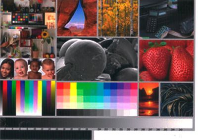

Download the test image from this site and open it in PSE. Don't make any adjustments to the file, regardless of how it looks on the screen.
http://www.outbackphoto.com/printinginsights/pi049/essay.html
Print the image using Print Studio Pro. It should be in the File->Automate dropdown in PSE.
11-25-2017 11:30 AM
John, This is very close to the print of the test image. The problem when compared with his image is that mine just prints too dark. You will see that my dark grays extend much farther into the light area than his sample. As far as the colors & gradulations, I think they are probably OK, just too dark. I printed one with my Canon i9900 and it looked identical to the sample image. You ake me to print from Print Studio Pro from file-automate dropdown in PSE. I don't have this showing on my drop down. Thank you again for your help. Mike

I installed Canon Studio Pro & the test piece printed even darker yet. How do I sent you a print dialog? It doesn't seem to want to let me copy & paste it?
