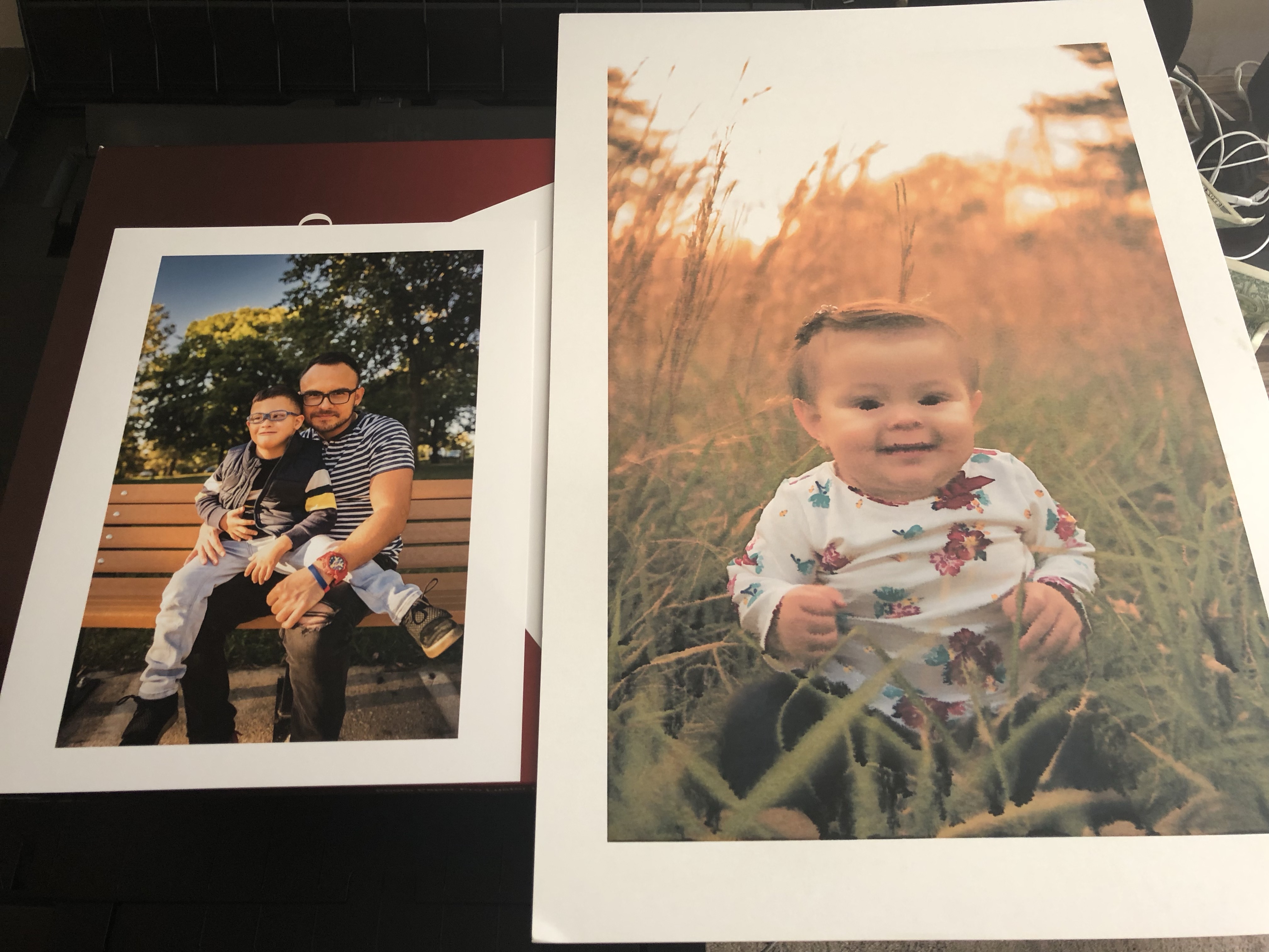

ok you were right about that I inserted in the wrong side up, but now i'm using a different size (13x19)  but same quality a pro luster and this time I put the paper correctly and now this happen, Why can I print really well on letter but when I try to do 13x19 that happen?IMG_0488.jpg
Was the 13x19 luster inserted right-side up?  Did you select the correct paper type when printing?
I have four different printers and it seems like if I change one thing, all sorts of things revert back to defaults and I have to be careful to select each choice.
Mostly I've developed the habbit of picking (1) correct printer, (2) correct media size, (3) correct color profile, (4) correct paper type... and (5) check the quality level.
I have to make sure all of those are correct before sending the job to the printer (and media needs to be right-side up).  Just occasionally I'm a little too rushed to check the paper and still get it wrong.
Tim Campbell
5D III, 5D IV, 60Da
Was the 13x19 luster inserted right-side up? YES, the back side is brown so I definitely know that it is in the right side
Did you select the correct paper type when printing? YES, is the same type of paper than the letter size
I already check everthing and stil don't know why this is happening.
Than you for your help.
The back-side is brown?  What brand is this paper?
I have a selection of papers from different paper manufacturers (Canon, Moab, and Red River ... but there are papers I haven't tried such as Ilford or Canson, etc.)
But ... most of the papers come wrapped in a pack where the top of the stack is protected by a single piece of card-stock (the top sheet isn't actually photographic paper) ... so when you said the back was brown it made me wonder if the protective card was inserted instead of photo luster paper.
Tim Campbell
5D III, 5D IV, 60Da
You were right again, Im soo dumb! lol THANK YOU
